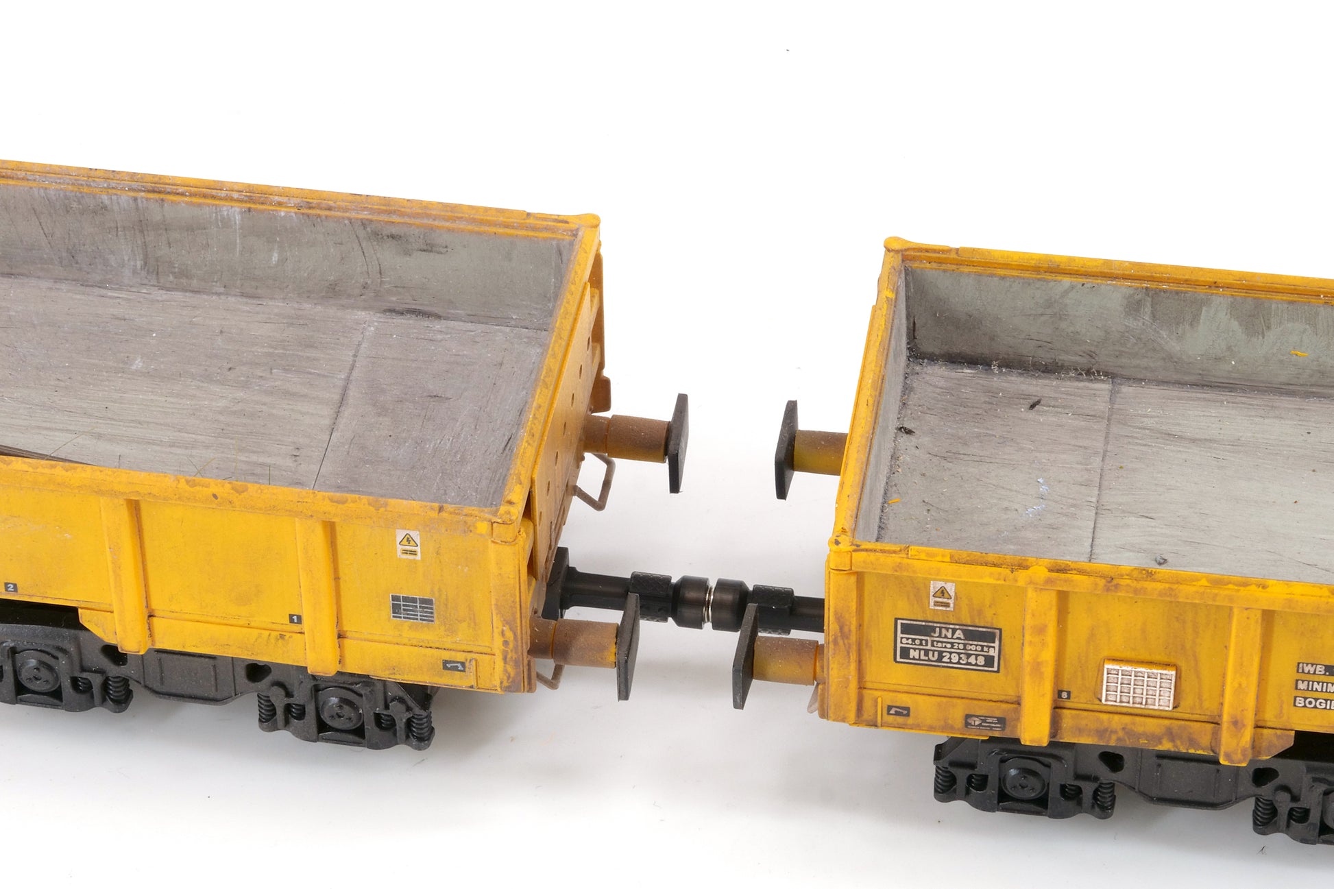

Fitting your new magnetic couplings is incredibly simple - just gently push the coupling shaft directly into your model's standard NEM socket until it seats firmly into place.
Compatibility Notice:
  • Standard Rolling Stock: These couplings are suited for standard NEM pockets across a vast array of modern manufacturers.
  • Step-Down Connectors: Please note that these couplers are not suitable for use with rolling stock that requires step-down connectors (for example, Bachmann Mk 1 coaches). On these specific models, the coupler will make contact with the chassis, causing friction that weakens the connection strength and impairs performance.

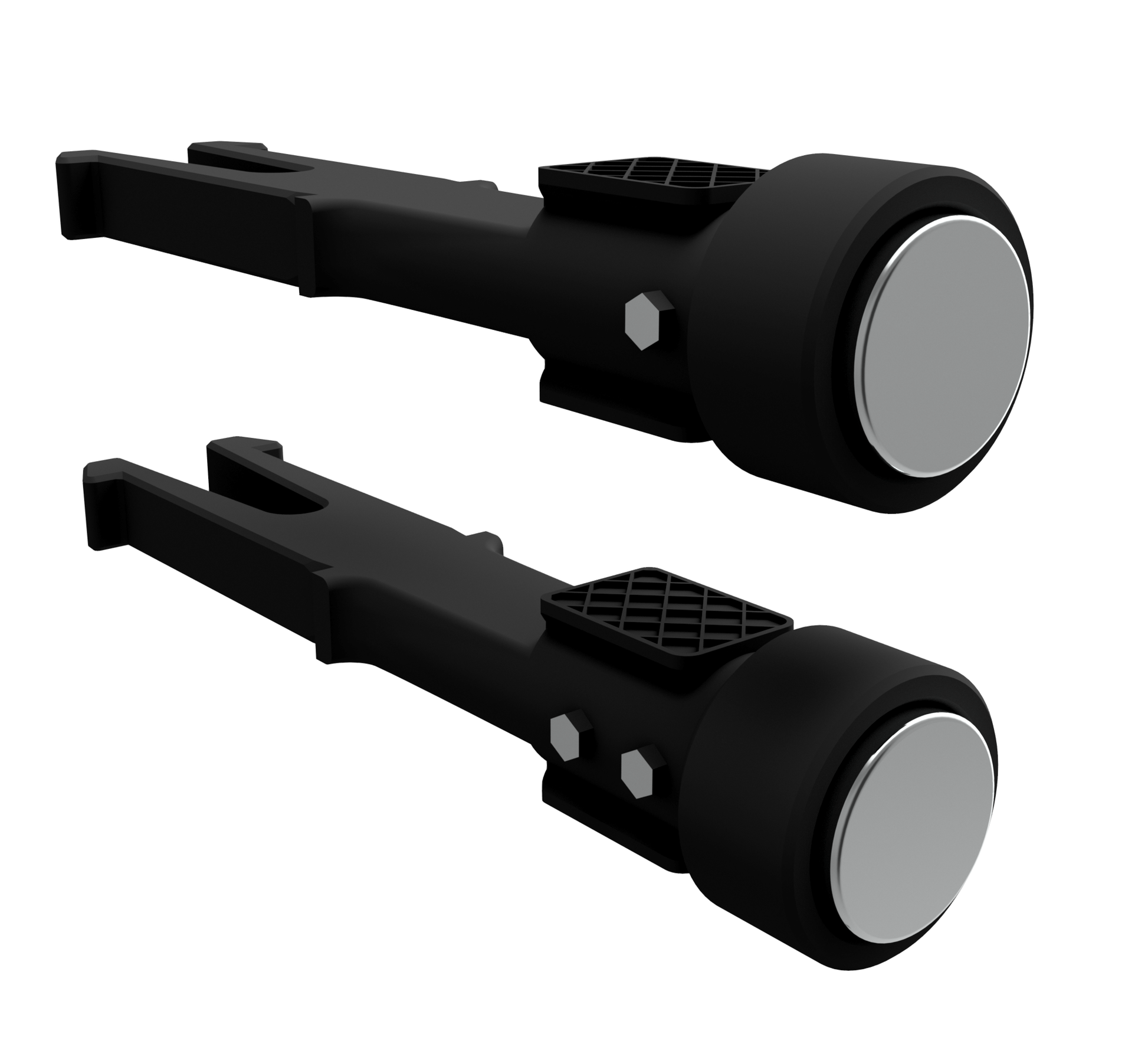

To ensure smooth operation, it is vital to pay attention to the magnetic polarity when installing the couplers across your fleet.
the polarity of each coupling is clearly indicated by the small moulded bolts located on the side of the shaft near the magnet.
When equipping your rolling stock, ensure that the indicator bolts align correctly across your rakes so the magnets attract rather than repel each other.
